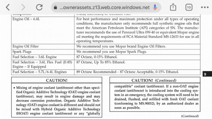

I filled up using both gasoline from Shell fuel. I ran 87 and 89. I dont know if it's me but truck seem to like 89 better. What is recommended gasoline for these 6.4? Mines a 2018, by the way.

Oh God..... not this again. Last time I think this went about 20 pages.
Cliff notes:
-Read the manual.
-89 octane "may" give a slight improvement in performance and MPG gain but usually not enough to offset cost
-Some swear there is an increase in towing power but those same folks also believe in ghosts.
Honestly, I have run a few tanks of 92 octane non-ethanol and gotten pretty good MPGs and power but I think it's more to do with the absence of ethanol rather than the octane. I only run that fuel due to camping deep in the woods and having only one type of fuel available. Otherwise, it's 87 octane regular.

We all know 93/91 is harder to burn then 87 or 89 right. Its a Compression thing. Run the lowest you can unless she spark knocks. Then bump it up one grade. Most likely the 6.4 will never ping off 87 unless its crazy hot out and pulling a heavy load(maybe). Mtofell is right the Absence of ethanol will always bring a couple of mpgs more.anything more then 89 for are 6.4's is a Waste of money.
