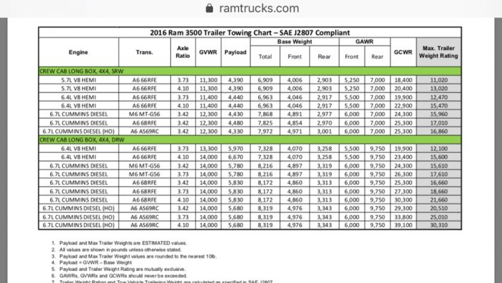

Re-gear it. I went from 3.73 to 4:88 and my truck pulls like a beast now for a gas truck.
Gears are the absolute BEST mod any truck owner could ever do.
if you look at the towing capacity of the same truck with 3.73’s and 4.10’s on FCA’s sheets you will see there is a reasonable amount of towing capacity increase. Now imagine jumping to 4.88’s.
Here is a screen shot and a link for you. My truck, 4X4 CC Long Bed 6.4 gains 3,000lbs towing capacity going from 3.73 to 4.10
The same truck with a 5.7 gains 2,000lbs
https://www.ramtrucks.com/assets/towing_guide/pdf/2016_ram_3500_towing_charts.pdf
