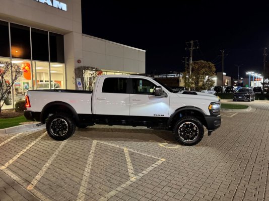

Hey all!! Appreciate the responses! Just a quick update. I went and test drove a 2021 RAM 2500 Cummins. I ended up buying a 2024 RAM 2500 Laramie Rebel with the Hemi last night. Got a killer deal on it, $12k below sticker and it is loaded. It seemed like the absolute best compromise. It has every bell and whistle I can ever ask for, plus some. It has a 2.9k payload capacity as it sits. The camper I am going to haul is 1,700, so it leaves me plenty of payload for my butt, the wife and our gear / gas. Already lifted, offroad tires, rear locker, etc. Honestly, no modifications will be needed except adding a winch to it, which I will get OEM parts and put on. Otherwise, it's got everything I need except the steps to get in (that suckers high!). Oh, and that Harmon Kardon sound system is absolutely incredible! Rides a little stiff on it, but that is to be expected for sure.
Overall, to answer the question, I had a 2017 RAM 2500 Cummins that I lifted and built out. It had the AEV setup on it, ran 37's and was a great truck. I had a Four Wheel Camper Hawk slide in. I sold the Hawk and the truck and got a RAM 1500 Rebel with a 23' bumper pull RV. I hated towing it, and hated campgrounds. I've regretted selling the first truck ever since. Knowing I wanted to go back to the slide in camper, payload was critical for me. Folks do use the Power Wagon for this setup, but most who do highly encourage others not to due to the softness of the coils. The Rebel seems like an absolutely awesome compromise because I am not rock climbing this thing to the point of needing a disconnecting sway bar and hopefully not a front locker. I think I ended up with the best of both worlds on it!

Looks like good choice for you. I like my 1500 Rebel. But have looked at 2500 Rebels. Looked at PW, but low payload/weight sucked for my use.
Add some steps and go get that white dirty :)

WOW! That's sharp! Congrats.

That is pretty bad@$$

Nice lookin pickup! Good job doing your homework…looks like the new rig will suite you well. Tough decision for sure, but i think you made a good choice!

To the OP, glad you were able to make a decision. Truck looks great and I think HEMI was the right choice.
