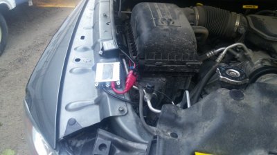

So i had high end piaa halogen bulbs since a few days ago when my kensun h13 bixenon bulbs showed up and the warning cancellor capacitors.
It was a very easy install and i drove infront of my truck in my wifes hetta and you dont need projectors pffft.
So after all was done my drl were flickering due to them not recieving enough power and so i did what i figure was the easiest solution to my problem...
I glued a pop bottle cap over the radiant light sensor on the front of the dash to trick my truck into thinking im driving at night all the time.
What do you all think of this quick solution?
Is there any real consequences to doing this?

To adjust the stock headlights...
You open the hoob and theres arrows pointing to two holes right above the back of the headlight housing on the top of the fender (its a 7mm socket)
