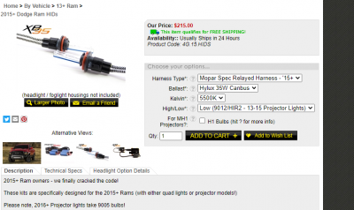

Send me a link to exactly what I need if you can.. I don't want to order the wrong stuff. Also, I don't have the alpha obd software to tool
