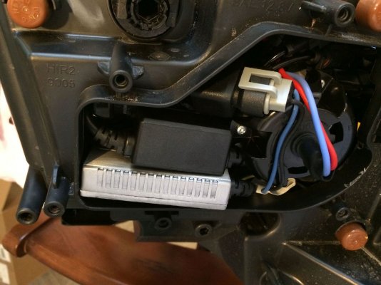

I have a 2014 with factory projectors. Get an HID kit with the CANBUS ballasts and you will be ok. I was actually able to fit my whole kit INSIDE the projectors....it's worked flawlessly for 2+ years...
Not to knock you, but from personal experience and talking to JJ @ Retro, it is not advised to keep the ballasts inside the housings. I mounted mine to the frame rail in the front by the grill.
you didnt use a harness with those??

He did not use a relay with the ones tucked in the headlight.
Do those ballasts not get hot? I should have shoved mine in there.
