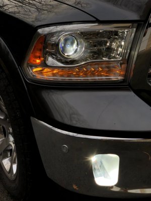

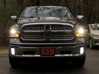

Hey guys I've been browsing and doing research trying to figure out if I should put LED's or HID's in my 2015 Ram Sport. I have the factory projectors with halogens and they suck at night and in bad weather. I know the Rams are tricky when it comes to this subject because of wiring problems and flickering and light out. I'm looking to get a very bright set that consists of the highs, lows, and fogs and that won't throw a light out code and fits behind the dust cap. If anyone has successfully completed this please let me know what you used and how it was done.
Not sure if you found lights or not. But I installed HID in my 17 Dodge Ram sport with no flickering or issues. Same with LEDS in my fog lights
