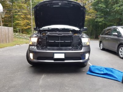

I got the lights installed this weekend without any real issues…other than breaking all 4 tabs taking the grille off…oh well. Ordered replacements from Clips and Fasteners for anyone interested: http://www.clipsandfasteners.com/Chrysler-Grille-Moulding-Clip-68213168AA-p/a21791.htm.
The heat sinks on the lows were a little tricky to get situated in the housing but ended up ok by taking them off and putting them back on after I put the bulb in.
Wow, these things are really bright! Way better than factory. The lows have a nice distinctive cut off and don't really seem to scatter much, if at all. The cutoff is pretty much right where the factory bulbs were so I didn't have to adjust them.

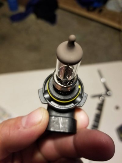

The fogs don't seem to fit as snug in the socket as the lows but they appeared ok. I mentioned this to Vanquish and they had me double check which fog light bulbs actually came out of the truck. Even though it should have been the H10/9145, it came with the 9006 bulb from the factory. They said that happened to another customer and they will be swapping them out for me. They told me the 9006 is 2-2 ½ time brighter and won’t need the cancellers. I put the halogens back in for now and will get these in as soon as they arrive.
LED drivers side, Halogen passenger side:

Can we tell what type of fog bulb we have without removing I wonder? Would prefer to be able to just order the correct one first :).

The fogs are pretty easy to pull out and check. Mine had 9006 stamped in the base by the bulb near the connector. You'll have to zoom in on the image, but it's there. ce8d747d2ad0ed19038966327a85e400.jpg
