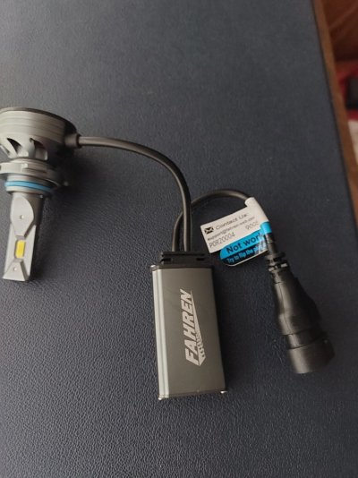

Re-surrecting this moderately Fahren oriented thread. Which Fahren bulb model are we talking here? When I visit Amazon I can find different versions of Fahren LED 9005's. Ones with internal resistors and some with external inline resistors.
Will the models with the external resistors fit inside the dust caps? Or are the wires long enough to install the resistors outside of the dust cap?
Thanks!
I bought this set of Forscher LED by Fahren sometime last May and didn't get around to installing them until just recently.
It contains a set of H11s & 9005s, however, upon opening my projectors I discovered that I require 2 sets of 9005 bulbs instead.
I have another set of 9005s arriving this Tuesday and hope to complete the installation of both sets soon.
I did test fit one of the 9005 bulbs and although it required a bit of fiddling, it did fit along with the decoder module. And I had plenty of clearance to replace the housing cover.
I no longer see the decoder module in the description but I grabbed a picture from one of mine.
