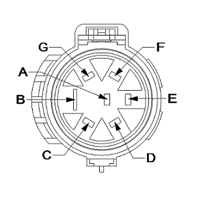

Hi..can anyone confirm the color of the hitch power wire in the hitch harness on 2021 Ram 1500 Quad,5.7. Intending to hook auxiliary LED lights to that power source. My power indicator probe seems questionable.

Here you are - this site has all the connector info you may need in the future
Pin Information​
CavCircuitGaugeColorFunction
AW7511.0BKTRAILER TOW BACKUP LAMP FEED
BW7552.0WHTRAILER TOW GROUND
CW7542.5DBELECTRIC BRAKE FEED
DW7521.0DGTRAILER TOW RIGHT STOP/TURN SIGNAL
EW7502.5RDFUSED B(+)
FW7561.0BNTRAILER TOW PARK LIGHT
GW7531.0YETRAILER TOW LEFT STOP/TURN SIGNAL
