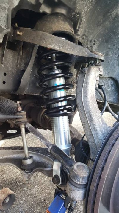

Front end is complete. Install went smooth aside from equipment issues. It was 10* this morning and I ended up blowing my big floor Jack out. Not the best start to things. My little Jack struggles to lift the truck. Anywho. I won't bore you with install stuff as it's status quo, but I didn't get to cycle the suspension empty and check wheel travel numbers like I had hoped.

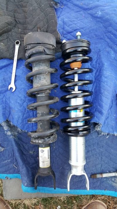

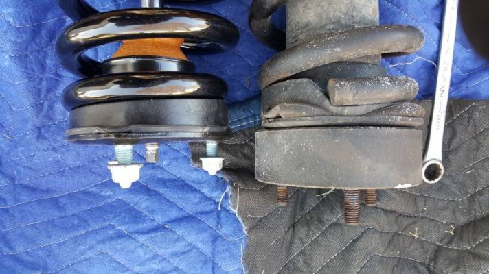

Ride Quality: my truck had spacers installed by the previous owner so I can't comment on the ride compared to a completely oem truck. My spacers rode awful, and I'll start a new thread on those reasoning soon, but I attached a picture in this thread of the damages I had incurred.
On the road, the small imperfections are there, but they aren't really more than a tiny thump. The bigger the hit, the smoother these things are. I hit a few spots that are chewed up and it rides incredibly well. I'd compare it to a nice European sedan, firm but compliant. The damping is very nice and they should smooth out a bit as they break in. IF you can track these down, I highly suggest them as I don't imagine 5100s ride even close to these. There's nothing close to harsh, it's 100% smooth and firm. Brake dive, body roll and nose float are all gone. By far a worth while upgrade. I'll update more detail after I log some decent miles.
Measurements:
Level spacer: 38"
6112s: 39.5"
Rear sits at 39.5" stock with 10psi in the bags
Spacer size: 1 5/8"
1 5/8 (spacer size) x 1.5 (leverage ratio of ifs) = 2.4375 (actual lift gained at the wheels)
6" (shocks stroke) x 1.5 ( leverage ratio of ifs) = 9" wheel travel.
so I'm gonna say that the rough calculations I had discussed with thuren were in fact correct. I was unsure of this, my memory isn't always perfect. So in fact we do have roughly 9-10" of wheel travel packed into the front ends of these trucks. I'm surprised to say the least. Once it settles to it's final height and I get a proper Jack, I'll see what my droop numbers are. Most of our travel is gonna be compression side, but it's still generous for an oem setup. Arbitrary mostly but interesting nonetheless.
I always had about 1/2-3/4" rake previously, so I assume the spacers I removed were for 2.5" level. Since they were previously installed that's speculation as idk what the rake originally was.
I maxed out the 6112s as per the instructions, since they are supposed to settle to about 2.3 inches of total lift. Should take a while so I'll keep my eye on this. My spacer measurement was never as consistent, I couldn't ever figure out why but it was always between 38 and 39. [emoji848] The overall length was just about 1" shorter than the strut spacer combo so the indeed are longer than the oem struts. Angles all look good, there's enough pics of that floating around that I don't think they are necessary.
Price:
6112s- $700
Parts to assemble + assembly - $485 [emoji54]
I had to buy ALL new strut hardware, my own stuff was unusable. After looking around I went with mopar stuff, I just didn't like the quality of the replacement stuff compared to oem. Yea I paid a bit through the nose but the hardware itself is just such higher quality I wasn't putting **** on a set of shocks i intend to have last the life of the truck. The shop I use also charges 110$/hr for labor so it adds up quick, but I have a warranty, customer service and longevity with this setup so I figure buy once cry once. I posted all the parts and PNs in the beginning of this thread.
Rear suspension should be installed next weekend weather and floor Jack pending [emoji106]ab33da50f623641c90a1b2e2981b0b94.jpg2d0f2f7462db68c00851db383c115850.jpg1d3fd0d3c86a75f7da8eda59c3866a7d.jpgd7ad8c22ce4c3f569c09523bafe3e101.jpg2158c55899ed3e498e6207f2d27ae7a9.jpg
