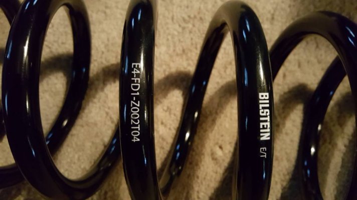

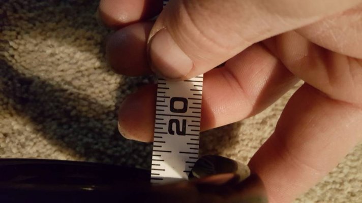

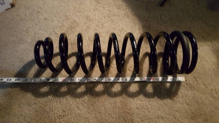

Nothing really fancy to see. Rear stuff came in. Got the shocks installed. Springs will have to wait till I can get a Jack and stands big enough I can trust working under it. Did the shocks with the truck on the ground. Wasn't hard, just aggravating.
Rear spring dimensions 19.5" hoping to install asap7cb93502cd3235ee346a6e83aea98bec.jpgd07187c780365c145553f4d852c88e69.jpg7d75df6bb8e215d11446828e219bb7af.jpg
Sent from my SM-N920V using Tapatalk
Were they both the same length even though they have different part numbers?
They look beefier than I remember my stock crap being. Can't wait to hear how they ride on the truck and what kind of lift you actually end up with.
Nice to know they're longer than stock.
I didn't even think to look. I'll check tonight, yesterday was hectic to say the least.

Confirmed, the drivers side is 20" and the passenger is 19.5"
