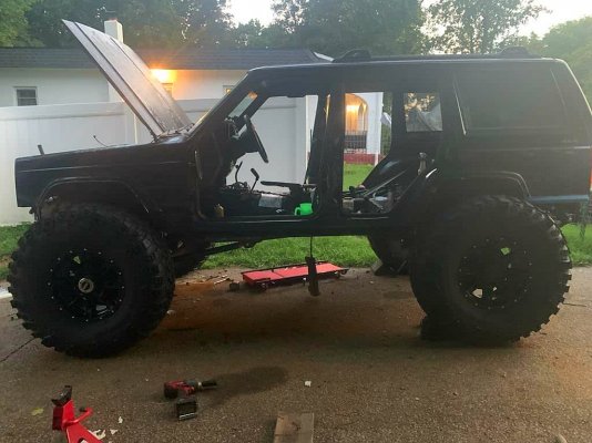

And since I'm low on truck updates for the current, here's that 1 ton cherokee on 41s as of tonight. Motor is rebuilt, new trans is in. Need to finish plumbing and wiring that all up, t case, steering, track bar, shocks, driveshafts, LOTS of body work/trimming, bump stops, than tear it down and paint the whole thing and final assembly.

Damn those shoes look massive. I'm guessing you'll have to open up the fenders a lot more or is she bumped up to the moon ?

That's why its been a push to get the big ticket items done. We needed it at ride height so I can sort his steering, track bar etc as well as figure out how and where we need to clearance the floors. I'm thinking we're gonna bump it at 3-4" up travel so its still streetable and the rest can be droop. Aside from fender sheet metal they fit surprisingly decent. Not as much chopping as I envisioned. Its 100% full body and the trimming on it was there with 33s. Don't get me wrong, its getting mutilated, but still they technically "fit" lol!
These iroks run true to size as well so they're legit gigantic. Overall this is pretty cool. Not what I would do, with a unibody rig but cool to do even still.

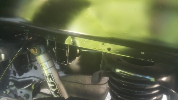

1 bottle of degreaser, 6 cans of rustoleum and a black face later and the frame/high impact areas are all nicey nice again. I hate doing this. There's no fun way about it, even with the truck on ramps, but living in the north east it's a necessary evil. Now I can hit some quick touch ups and it'll be good to go for winter after a coating of krown. Not the best pics but the entire frame nose to tail and the floor boards of the cab outboard of the frame got sprayed.
I like rustoleum since it cures well and lasts pretty damn good in the winters up here. For as durable as it is cleaning the over spray is easy, 91% rubbing alcohol pulls the heavy deposit right off the paint and I'll likely clay bar the truck since it could use a little love. Once that's done I'll wd40 the paint and call it good.
