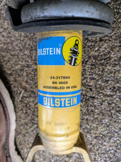

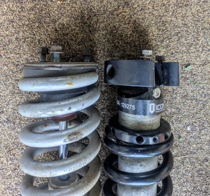

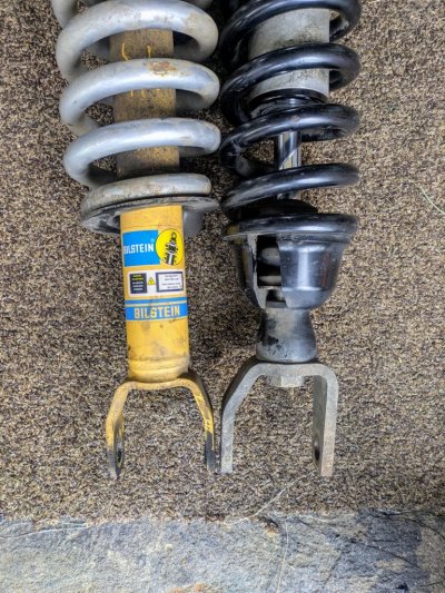

Interesting discovery. The 4600s I put in last year are the same length as my icons. Wonder if the classic models were using 5th gen front struts? AFAIK the icons are extended vs OEM 4th Gen stuff. I'll be interested how they ride with my stock coils.
Planning on pulling off the eibach coils and going back to the OEM set to the 1" notch plus my little 1/4" top shim spacer. Icons will stay on for the time being as the adjustability is huge for me right now. Eibach stuff rides good but just sits too tall for my needs right now. I've been doing a lot of towing and being able to drop the front has been awesome. Allows me to run level loaded and saved me from having to spend the cash on new UCAs for the time being.

Icons front, Bilstein Rear coils and 4600s (longer than OEM)
Lowered the front with my icons vs buying new UCAs right now. Tossed Bilstein coils in rear to drop it a little there as well. Levels out perfect with loaded trailer hooked up. Once I'm done renovating and moving into new home and selling the old I'll have time to get my fuel wheels done, windshield replaced and see whatever else it needs by than. Close to 250k on the odo now.

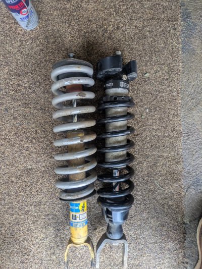

Icons officially started leaking this week, passenger side, which initiated a bit of a rabbit hole of work on the truck. Things have been insane here and I have not done anything but drive the truck ,A LOT. Long overdue for some time checking things out to say the least.
Truck has been in regen a bit more frequently than normal and with moving I am getting fuel at different stations that I'm unfamiliar with. Definitely need to tighten intervals and keep an eye on this.
Pulled the eibach coils off the 4600s, preloaded stock coils to the highest clip and added that 1/4" spacer. Sitting around 22" (+/-) in the front, 24" rear. Took a spin around the house to settle things so TBD on ride vs icons and the eibach coils. Not that I need the benefits of coilovers any more but the ride quality on torn up roads has always been something I've been pleased with. Pic of icon shaft is after I cleaned it to confirm it was oil. Lower mount and bump are saturated, just hard to get a picture. Best guess is these have about 80-100k on them.

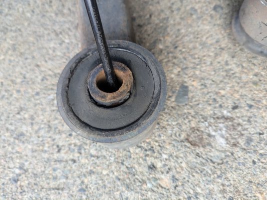

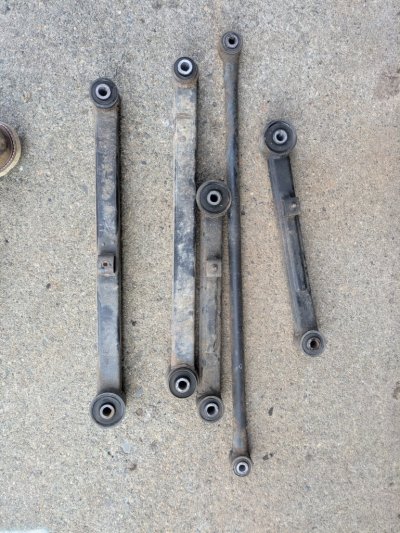

258k on the old girl and finally did the rear control arms and track bar. Bushings were toast but in better shape than I anticipated. Felt some clunking when I was towing a machine a few weeks ago and figured the arms were shot.
Picked up some rebel take off rims locally I need to get cleaned up and swap tires onto. Current wheels are going to get a set of winters tires soon.
New house, 2 kids and 2 jobs doesn't allow much time for anything extra. Hope all is well with everyone.
