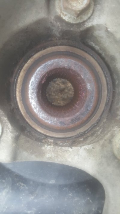

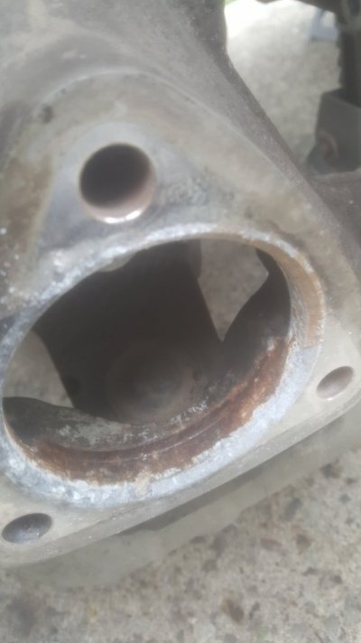

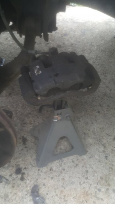

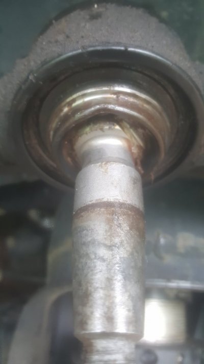

Pic #1- Pro tip- don't bother trying to hang brake calipers, just lay them on a jack stand and slide them out of the way. Alot easier than wrestling with some nonsense and trying to figure a way to hang them.
For reference truck has 156k on it.
pic 2- what both wheel bearings look like on the CV side after 156k
Pic 3- inside the knuckle....dissimilar metals and corrosive environments take their toll
pic 4- cleaned up and looks like a ****** gnawed it
pic 5 - upper BJ in my ready lift arms. They're still in perfect shape after 50-60k miles. Only noticeable wear is the little indent in the socket hosing where it hits at full droop. Cleaned the old grease out, new boot on it and I'm gonna run it.
To be continued.....

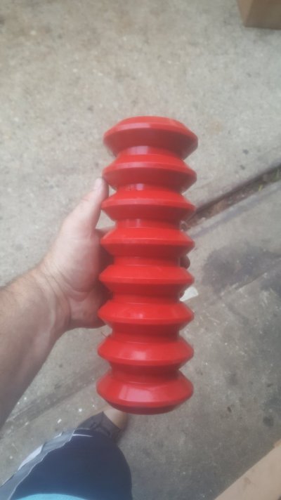

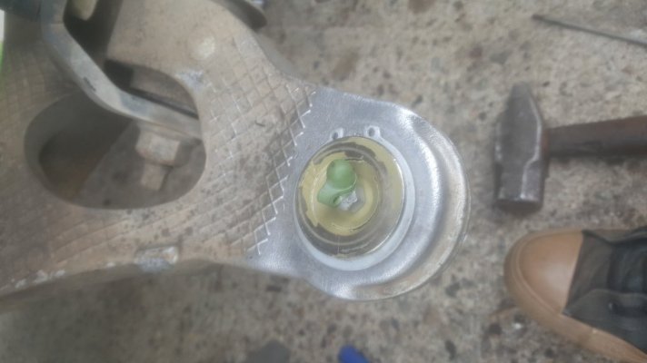

Pics 1/2- mevo tech ttx lower BJs. Seem like a decent unit and a bit beefier than the stocks. Much larger body wise but no issues with fitment of the seek, just need to orient it properly once the hub and CV are installed.
Pic 3- the aftermarket CVs I got seem to feel better in the hand than the vatozone ones I pulled out. Only issue was.....with icons or any extended length front shock for that matter, the boot band hit my LCA and i had to be amazed flat. Things like this are aggravating and you won't know until assembled. Always check things, this would have resulted in a blown boot had I not spun the hubs to check.

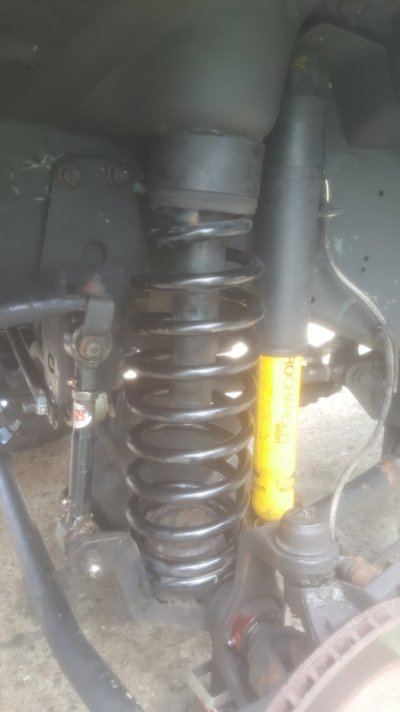

Pic 4- @ram1500rsm thought of you and our discussions about bump stops. These are prothane coil inserts. Gonna be going on the front of my jeep since I'm not diving into huge fab work to fit hydros on it. They are 10.5" long and will compress 30-40% of their height, are a rebound- less multi cellular foam, and seem super popular in the jeep speed world. Might be something to look at for the rear if you want a progressive bump out back. We're still screwed up front though. I'll report back on how they feel in the jeep once I get them in. It'll be a bit before that, but still might be something we can utilize in the rear setups.

So I gave my buddy the 1" daystar spacers and we installed the 6112s on his truck. Same exact truck as mine, IE- Crew Cab Eco Diesel. Bone Stock 76k on the truck
Started out-
36" front
38.5" rear
6112s set to the max (2.3" per bilstein)
39-39.25" front
39.5" rear
I'm thinking after alignment it should come down a little in the front since it's way bad alignment wise. Still interesting to see that he got so much lift out of it. If it doesn't come down after alignment were gonna drop it at least 1 clip in height.
This is weird to me, since I never managed to get more than the 2.25" at most out of them. He's on stock UCAs so I'm hoping we don't have to pull it back apart.
Started out-
36" front
38.5" rear
39-39.25" front
39.5" rear
3” lift out of the 6112 on his truck? Something seems off. You sure that things got the eco diesel? Lol. I’m sure it’ll drop some but I can’t see it settling 3/4”
Dude swear on my dog! I didn't mess with the setting on them cuz they were set to 2.3" and he had enough rake I figured it would be fine.......yeah right. Luckily i had the 1" spacers and its perfectly level. His truck was 100% untouched.
Only thing that kinda could make sense is that the front struts were sagged or a softer factory option. His is a fancy bighorn model with no skids or tow hooks so maybe it's got girly suspension? Looking back in this thread I started off at 39.5, settle to 39" and only dropped after I added the UCAs with proper geometry. He's happy with it, so I'll see how it aligns and report back.

Maybe you have something in yours that weights a lot more?. or Maybe the springs in his 6112's are different ? 1" is a lot of height difference considering Bilsteins run super close to the heights they advertised. Could be normal too as they haven't settled. Typically 0.5" less after some miles.
