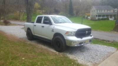

Spray paint and boredom to change it up. Not really worried much since I'm planning on bumpers this summer. $5 can of paint is enough to satisfy my desire for now

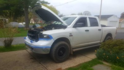

Flares are off and I got bored and spray painted the front bumper cap white. Was doing my normal spring cleaning and decided I'd color match that piece. Strictly influenced by boredom and a can of paint I found in the basement from another project. Looks good enough it'll do until I get myself some new bumpers this summer. Also on the hunt for headlights since the cheap Amazon ones just don't allow good light output and the stock quads I put back in are both broken and rigged in place. Lol. They're solid, but need replaced. Adjusted perfectly fine thankfully so add it to the never ending list.
My paint is pretty much shot at this point and the cost of a paint correction vs doing bedliner color matched is a no brainer. 5 years of no wax or coating has taken its toll lol. Hopefully the sample colors come in and I can decide what I want and figure out how much I'll need. Thinking of some 2 tone ideas to break up the white blob that this truck is.

I like the upper fascia being color matched rather than the black. I would love to do my entire truck with the raptor/custom coat liner, not sure if I would just do GM white to match existing or go with the aircraft gray I used in the trailer.
I had this can of paint laying around and it says it bonds to plastic so I said screw it. It's close enough in color I like it.
I'll post up the color chips when they get in. I'm doin the truck mostly in white so I don't have to change the title or deal with cops. I'm not sure if I wanna do black since it can get storm-trooper ish. In my head the roof and lower body line/fender flare arches will be done black/a contrasting color with the rest white. Still researching if I'm better off spraying it all or rolling the majority and spraying uneven spots. I'm trying to time it to coincide with bumpers and body lift so I can do it all together. I've never been a big "wax my truck" guy so this is my perfect answer.
That grey you did the trailer looks awesome and is one of the colors I'm considering for a contrast color. Monstaliner is the company I'm looking at using.

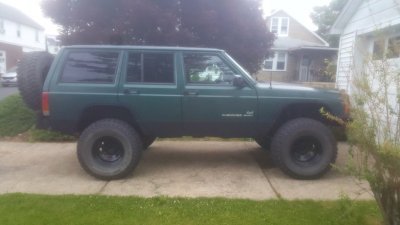

Pretty much been consumed with helping my buddy drop one tons under his xj. Unibody stiffeners, suspension and everything. Between this and my own pile of dog poo I call my jeep the truck hasn't been touched and will probably be staying as is. I'm not goin anywhere, just won't be as exciting Any more. The truck performs perfect as is so I see no need to really mess with it much more. Boring I know!
My little green xj is currently sitting on 33s, once I get the last bit of mechanical and functional pieces sorted, it's getting a fully plated frame, 3link and I'm tubbing the wheel wells for 35s as well as some mini boat sides/2x6 boxed rockers tied into the frame.

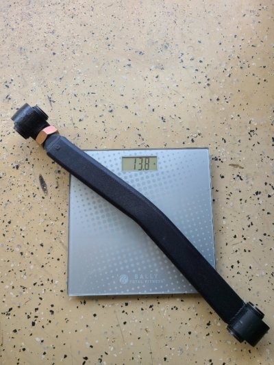

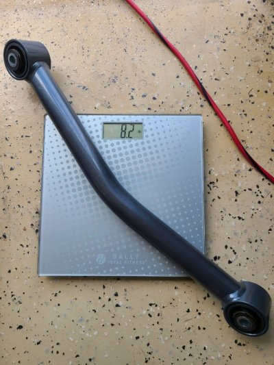

My Clayton arms showed up today so i took 20 min of my afternoon to get them in.
Pure ******* beef, literally 14lbs each
51300165854_ac52382eb4_k.jpg2021-07-08_07-45-49 by RAM RSM, on Flickr
Compared to the Synergy fixed arms i just replaced @ 8lbs. Damn it they have just one month :)
