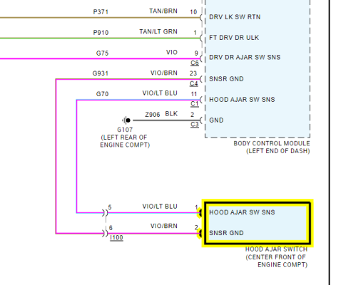

I installed the hood latch with the switch in it (by the way that is all it is, a push pin type switch NO resistor.)
It still kept saying hood open so I start tracing wires and all mine are there. Turns out the ground side of the wiring was not grounding. I ran a new ground wire to the switch and now the hood latch works like it should.
Use Remote start then, use hood release and truck dies. Resistor is set to 1k resistor in AlphaOBD and that is just about the resistance from ground bolt to the pin 11 on C1 A under the dash.
FYI Mine was .994 ohms resistance through the factory wiring to my add ground wire on the Ground lug on fender.

Just for reference, this is all the hood latch does. Looks to only be grounding BCM Connector 1 Pin 11 and thus closing the circuit.
