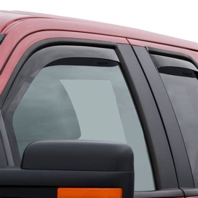

I have these and open the rear passenger window opposite the driver to the bottom edge of the deflector and open the rear slider. Perfect air flow no buffeting.
What brand are they, TRK?
