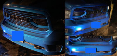

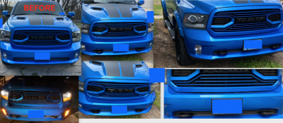

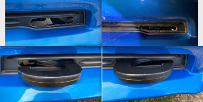

Well guys. I finally did it!!! Took 4 hours because I didn't have a deep 18mm socket so had to run to Lowe's and then working on the last hook the damn Harbor Freight 1/2" torque wrench exploded!! So got stuck using 3/8" torque wrench with breaker bar and shallow 3/4" socket which absolutely sucked.
Shoutout to @crazykid1994 for the tow hook brackets (sanded off most the rust then did 3 rust base coats & 2 black top coats), eBay for the bolts & tow hooks (new without box and slight scratches I'm hoping don't rust), and the one member on the forums for the BEAUTIFUL trim recommendation to clean it all up (woulda looked like trash without the trim)! Only complaints I guess are the trim where the two ends meet, didn't think about it before installing the hooks permanently or would have had to trim piece end another way and it’s not EXACTLY even on each side, but can't complain actually came out wonderful.

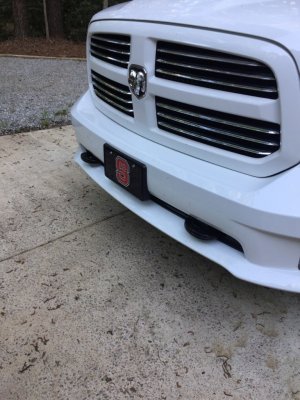

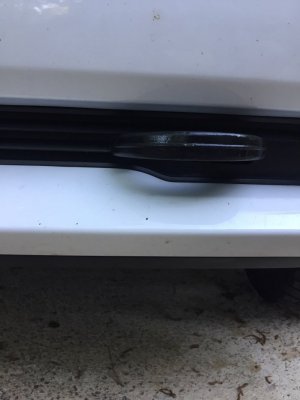

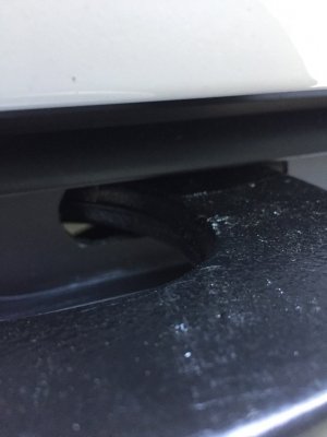

You can easily get more room under the bottom of the hook and the bumper with a little modification. Just drill new 1/2" holes under the existing holes in the mounting brackets and chop off the alignment tab as well as 1/4" from the metal between the tabs. It'll raise everything up 1/2" or so and center the hooks where they should be. I opted to make the install challenging by cutting a hole just big enough for the hook to pass through on each side and install the hooks and the plastic filler piece as one unit. Took some maneuvering but worth it.

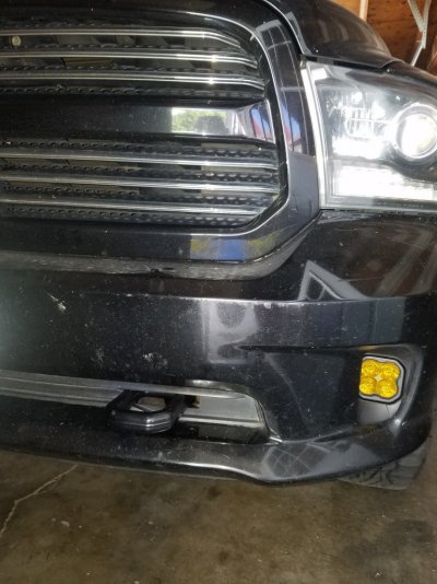

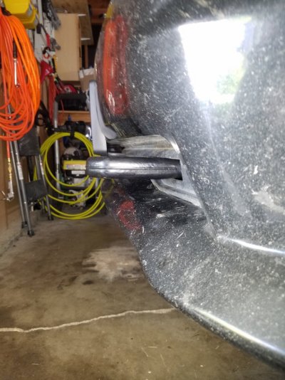

I decided to go for this mod before winter set in. Thought itd be interesting to try the 4th gen rebel hooks since I havent seen anyone else do that yet. Had to modify the bracket to get the hook centered in the opening. I predrilled 5/8" diameter holes 15mm below the factory, cut off the centering pin and ground down the middle area that wraps the frame. For cutting the plastic I used a jig saw and hit the edges with a map gas torch to clean up the fuzz. I feel like the rebel tow hooks stick out enough to be pretty useful, but they really mess up the sleek look of the sport bumper so I'm not sure if I like them or not. I might get a set of the standard hooks and see how they look also.
