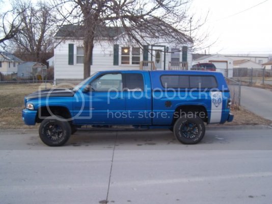

This is how my truck sits after I installed 2.5" leveling kit, and new shocks

looks nice!! no i got a add a leaf. and i might make sorter shackles. i didnt want to do block because i didnt want even more wheel hop then it allready has. and i like my truck to sit like the factory had it with the front sitting lower then the back
