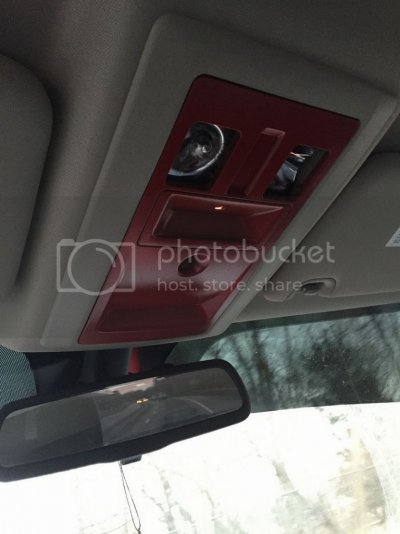

Sichemi
Mar 21, 2015
49
16
Just did mine last week. Start at the coner and give it a good tug down. Just like he said 4 clips . And def do not start at the windshield they are not clips. And becareful of the wires. The one for the lights is very short and you need to wedge your hand in to unplug it. Then the small led that shines on the cupholders is a bit tricky to get out. Here is why I took mine down ..(lenses are not back in. Waiting on my leds to come) image.jpg
Power247
Jul 26, 2012
5,615
947
High Point, NC
6.4 HEMI
I need to pull mine down to fix a rattle that has developed... Using the pic above as a reference... Does the entire plastic part pull out or just the section that Sichemi painted??
