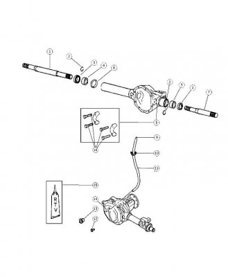

Is this diagram somewhat accurate? I got it off of the mopar parts website itself. I would need parts 2, 5, 3, and 7?

Anybody? Please help. I want to collect the parts by this weekend.
