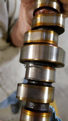

20200211_143938.jpg 20200212_112033.jpg 20200207_155526.jpg 20200212_101846.jpg View attachment 195147 View attachment 195148 Great article but I need some assistance here. I have a '12 1500 5.7. Lifter on 2 seized and ate the cam. I do have MDS. Lifter and cam were replaced with stock from rockauto. I didnt have the time to do it so I had a good friend who's a mechanic do it. Truck is all back together.
Problem is, it started and idled fine. They test drove it and it died. I got it to start again but when I drove it, it wouldn't go over 1k rpm. I got it back around front to the bay and it died pulling in. It tried to start a couple times, the rpms jumped for a moment then back to nothing. Now it doesnt try at all. Battery is good, all fuses and relays are good. Hes gone over every connector multiple times and they're all connected.
We cant figure out why it wont start.

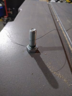

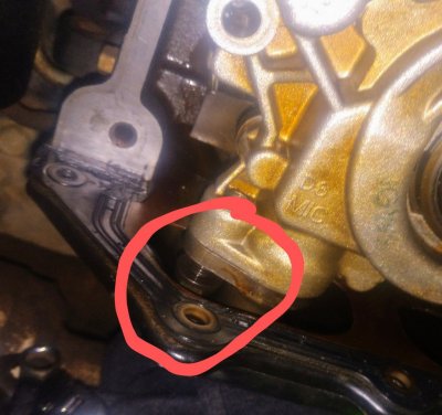

When timing I pulled the oil pump off. Got the open end of a wrench on the pickup tube bolt lifted the pump with it and slowly got it out. Getting the bolt back in proved to be much harder than getting it out (I didn't drop the oil pan). Have a magnet handy to fish it out of the oil pan if it drops. To get it back in I put a rag into the oil pan and wrapped 10 wraps or so of fishing line around the Bolt. Put the Bolt into the pickup tube and placed a small magnet on top of it to hold it there. The rag also helps to hold it in place. Put the oil pump back on and twist it so it's seated properly together. Use a finger or the fishing line up the bolt then pull the line so the bolt threads itself in. It worked for me. Hopefully It'll work for someone else tooIMG_20200505_193917~2.jpg

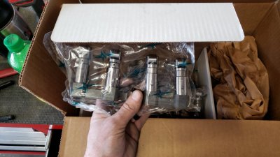

I deleted the MDS system and found the easiest way to remove the solenoids was to break the top off them. In the middle there's a little plastic cylinder with a hole in it and a slot on either side. Use a small flathead to keep it from spinning and put a screw in a couple turns then use a nail puller screw driver to pop it out.IMG_20200506_154421.jpg IMG_20200424_214905.jpg IMG_20200424_214858.jpg

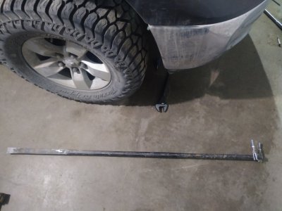

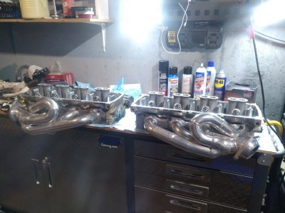

To remove and replace the crank bolt I used a 5 foot cat bar with a u bolt for my exhaust and a bunch of washers to keep the crank from turningIMG_20200419_214759.jpg I removed the heads to do lifters and reinstalled them with bbk shorty headers. If you're gonna do Shorty's I would suggest doing them when the heads are out. The only thing that needs to be done before the heads go back on is bending the oil dipstick tube down so it clears the headers. IMG_20200504_211138.jpg

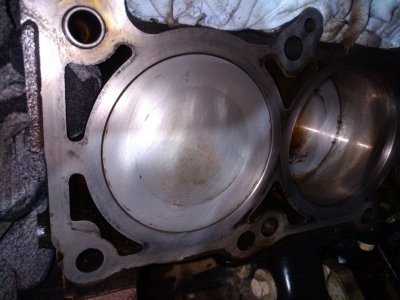

Taking the cam out I found it binding until I moved cylinder 1 to TDC then it was easy.IMG_20200427_211118.jpg IMG_20200424_203325.jpg
That last photo there should go with the MDS plug thing in the last post.
