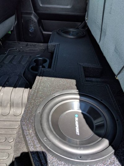

I replaced all factory speakers then added a loc to the wires on the b pillar on driver side.... Ran everything to rear of truck and wired in an amp and 2 10" subs in a box a got from Amazon....

Can you link to the box you got, on amazon? Also, i know you said you upgraded all your speakers, so this is a bit hit or moss, but do those 10's give you the bass you were looking for? Is it subtle, or something more like bang bang in the back if you really wanted it to be? What's the RMS ?
Rockville Dual 10" Sub Box for 2002-2015 Dodge Ram Crew/Quad/XCab/1500/2500/3500 https://www.amazon.com/dp/B018TYPCG0/ref=cm_sw_r_cp_apa_KvuqBbRB5SF0F
Subs I bought at Walmart for like 18$ a piece...
It's not gonna be heard down the street but it's perfect for what I was looking for... Aka loud enough that it will hurt my ears but deep enough bass that I can feel it while driving....
SCOSCHE LOC2SL Car Stereo 2-Channel Adjustable Amplifier Add-On Adapter in Black https://www.amazon.com/dp/B00LIAHSM4/ref=cm_sw_r_cp_apa_KzuqBb3QKVDD9
This is the loc I used and tapped both speaker wires together and then used the wires off the b pillar beside the driver's seat....
Ginsco 67pcs 24-10 AWG Quick Splice Solderless Wire and T-Tap Electrical Connector Assortment Kit with Case https://www.amazon.com/dp/B01L74LNCG/ref=cm_sw_r_cp_apa_hBuqBb23P95KN
Used the clips to splice into those wires and ran everything to rear seat then cleaned it up
