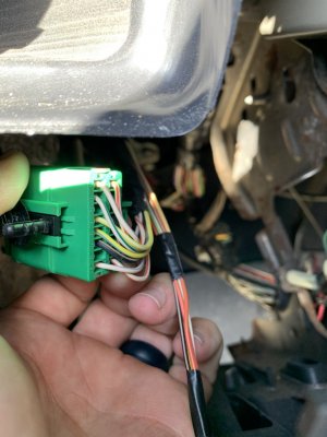

Question....about to install my console in my 2015 tradesman but i dont have schematics and want to know where i can best tap into for just the reading lights 3 wires. Below is my current green connector on driver side dash panel. Any help is greatly appreciated.

Ok, so i installed mine today, no compass or LED just the courtesy/map lights. Was really pretty simple, and took about 1 hour. Wiring wise here is what i did:
1. Ground i spliced into dome light ground just above green connector (too half)
2. Courtesy pwr spliced into same place but the other wire.
3. Map lamp pwr i splice into the yellow/ligh blue wire on bottom side of green connector.
Thats all it took for just the lamps. I did make a template out of cardboard to cut the headliner which came out perfect.

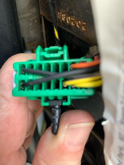

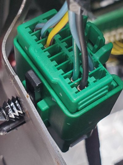

Here are some of the originals...
console and retainer
pin-out kit
green plug access (left side cover can be removed for access)
green plug (bottom 3 banks with black left, empty center and yellow/wht right.
I have a wire where they are saying plug for power.
Should i just tap it like other two?

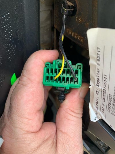

Did you figure this out? I have the same question on my 2018 Tradesman 2500. I've attached a picture of my green connector and I'm trying to figure out how to connect the (3) pigtail wires from the console to the green connector. I'm just doing the map lights. Any help would be greatly appreciated! Thanks.
