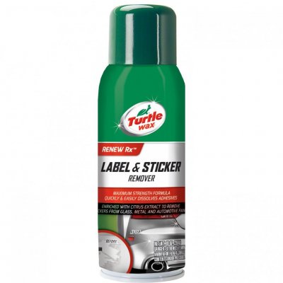

I did mine last weekend. Used the fishing line and pull at 45 degree method. Worked like a champ. To remove the residue I found a product by turtle wax called Turtle Wax label and sticker remover.
Once the gunk was gone I washed again with some car wash to clean the remover off and then waxed the areas. No evidence what so ever I had badges at all.
A pic of the product I used to remove the gunk left behind.

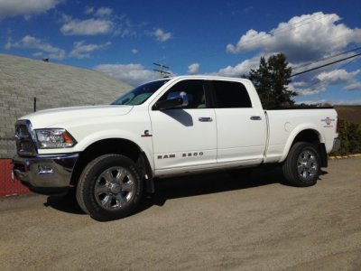

I debadged and then rebadged to the lower section of my doors.
