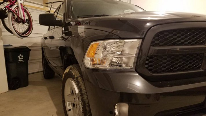

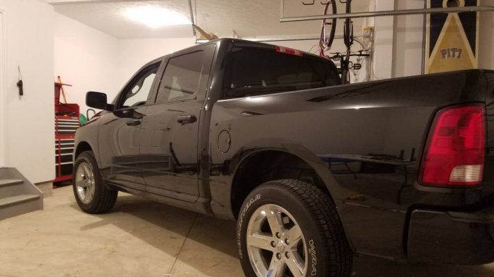

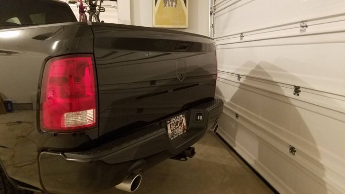

Did mine today. Didn't expect to have holes in the tail gate behind ram badge. Guess I'll have to order a black badge.3bd435dd2ef5f501f7c16b2efc3d0a54.jpg610355487606f7fe79f2e0ae02bad387.jpg51c55a9e25bf5d7d300ec67f50ee267d.jpg
