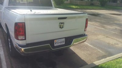

I'm not sure, it seems to be recessed into tailgate and one piece. The front one is just clip tabs&its a two piece. So I took it of and did this

Did the same thing on my Charger, and plan to do so on my Ram - only the chrome will be done in black (like on my Charger)...
Would be nice if the rear one wasn't recessed in there though. I'd love to remove it and have a nice clean, smooth tailgate.

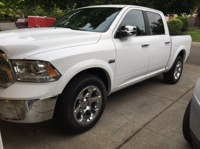

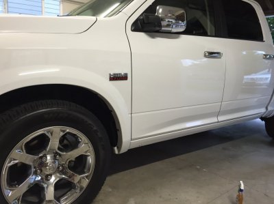

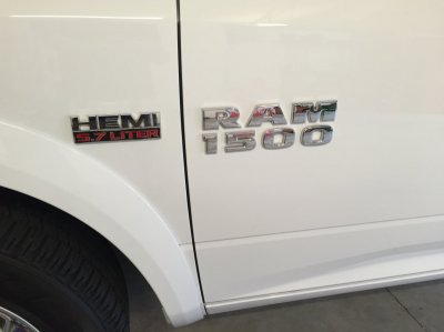

I really went back and forth on this...
I couldnt decide if I wanted to do it or not. Though I did think Ram went overboard with both the rebranding plus the model number as opposed to my third gen which simply said "RAM" on the side. Then I sat there and looked at my wife's Cadillac SUV next to it in the garage and noticed the minimalistic approach Cadillac takes.... A grill badge, a gate badge, and a small model badge on the tailgate. That's it. By comparison, my Laramie, which cost more than her Cadillac, looked like it was pimped out for a NASCAR race. That's all it took for me to decide to do it.
First pick was taken at 7:00p. The last one at 7:30p. Completely finished.

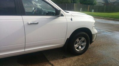

Maybe I'm the weird one but hell I just used fishing line, took the letters off then peeled the 3m tape off the truck no residue and took me all of 10 minutes to do both doors lol.

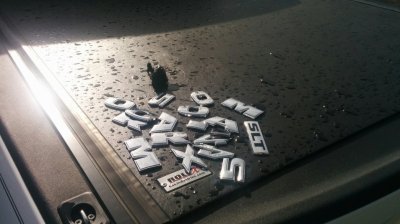

I just did mine today...Do not use heat ! I've been de badging my motorcycles and cars for years. Use fishing line to remove the individual letters or numbers..move the line back and forth in a sawing motion...then one off..with the sticky tape COLD...roll up a corner with your finger so you can grab it and gently pull it TOWARDS you and it will release...its the same process as removing the sticky tape on those new 3m wall hooks...don't just try and pull it off without pulling it towards you to release the glue...once off I used a little goo gone...then buffed and waxed...simple...took about 15 minutes a side to remove the 1500 RAM logo
