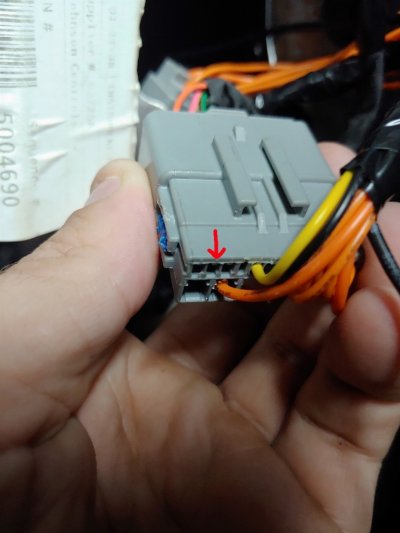

Orange wire with a purple tracer is labeled "LIN BUS CBC2", disconnected it, and everything was as I had hoped. Mirror doesn't know it is in reverse, therefore the monitor never even lights up. Radio still shows the camera image.
The microphone still works, but I didn't check anything else. Auto dimming should be internal and unaffected, and I can't bring myself to push the 9-1-1 button. Might try the assist this evening and see what happens. I do not have the rain sense wipers, or auto dim feature, these could be affected by that wire.

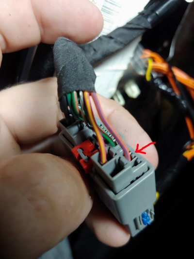

I used a sharpened paper clip to remove the pin connector on the harness from infotainment, and the put heat shrink over the exposed pin. I reconnected the video feeds to the mirror, as the monitor isn't powering up anyway. If I ever want to put the image back in the mirror, I just have to pull of some heat shrink, and plug the pin back into the connector. I chose to make all changes on the infotainment harness, so that all of the OEM wires and plugs are 100% unmodified.
Took off some extra wires for practice first. So there are 3 missing in the picture. Middle one is the only one that needs to be disconnected.
This is all on a 2014 Ram 2500 with the 8.4 inch radio, and required software according to infotainment.com

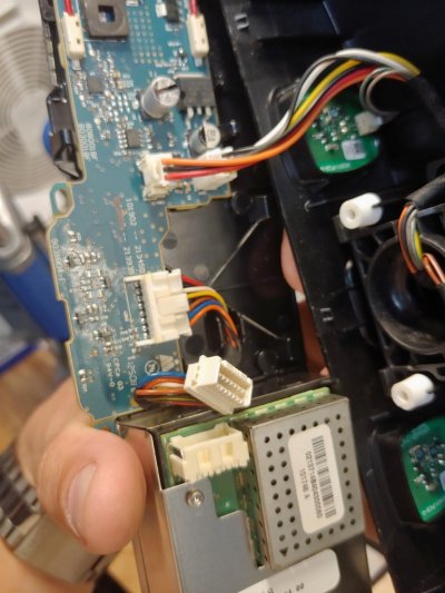

Since that takes out the easy way of disabling the mirror monitor, I had to do it the hard way. I get too focused on what I'm doing to ever remember pictures, but I got one at least.
I removed the mirror from the windshield, (youtube this, its easy, but a different style of bracket) then took it to my workbench. I've changed out a few cell phone screens and internals, so I have a kit to keep from marring plastic as long as you are careful. Using the plastic separators, I was able to remove the plastic mirror housing. The little plastic around the glass is inside the bigger plastic in the back. Wish I had a picture, but if you are interested in opening the mirror and need help, let me know and I can get more detailed on how to remove it.
I actually ended up disconnecting both sides of the wire and removed it so there isn't anything left inside to rattle.
Now everything works, and I don't have a screen blocking half of my mirror when I need it. I'll probably never act on the thought, but since I've now seen the inside of the mirror, I would be curious if a separate wire could be run to use the monitor for something.
