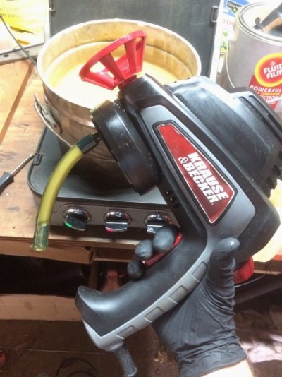

All iv been using is a Harbor Freight electric paint sorayer with just one modification. Works well.
Just warm the fluid film before spraying.

What's the one modification??
Cut off the straight plastic suction tube just long enough so I could slip this hose over it. Put a bend in the hose with a heat gun so it’s sucking from the bottom of the container while I’m laying on my back on the ground
OK...got it....Thanks!

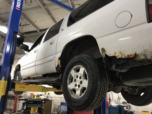

Definitely a Michigan Truck. On the hoist next to mine.
