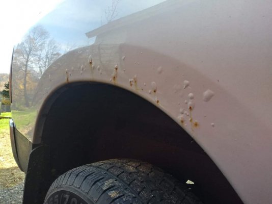

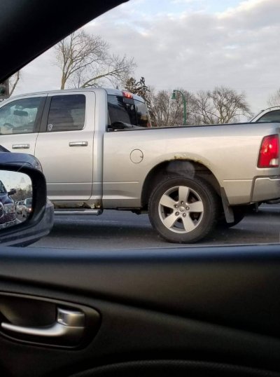

Get some FF/Krown/NH Oil/Corrosion on your trucks if you live in the rust belt. These are 2 different trucks but both are up here in New England. This will happen if you don't!62eb502098613f0706436cf103fc6f4d.jpg30e6c4449e38fb376d636217063843ac.jpg

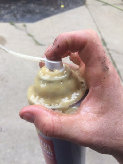

Cans don't work fer****, you need a set up like Corey. I did cans on mine, and even in mild CA it just didn't last long.
Very true
Cans work “OK” at best with the 24” 360* straw extension for in your doors and such. But they suck for anything else.
If you don’t have an adequate compressor for a real spray gun set up you can cheat with some electric sprayers if you warm the fluid up.
But the fluid film gun is the best choice. Extensions and all.
Here’s a good example of the frustrating things the cans do when using the 360* extension designed for them
