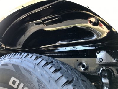

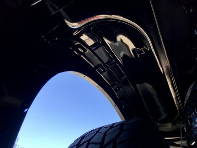

So I tackled some rust resistance the other day in the rear quarters with POR15, Phospho, and amsoil HD metal protector.

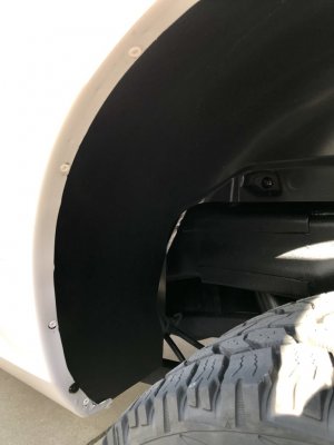

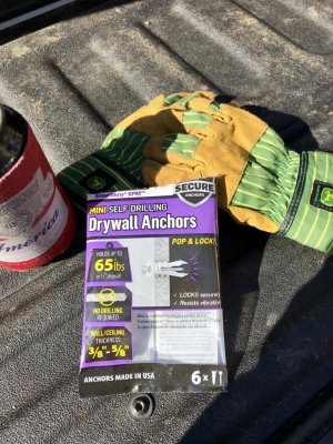

Nothing to do with FF, but I found something that worked and figured I’d share. I replaced the metal clips and screws in the rear wheel well liners (metal clips on metal panels with metal screws) with drywall anchors I found at Lowe’s. They work for the majority of the holes, and I used a Christmas tree clips for the couple they didn’t. No metal holding the liners in, nice and snug, and since my truck is white, it’s a little cleaner look.
2A8C6FD9-D3CF-49C7-8AA9-BE366ACDA148.jpeg E0D93BFB-CE8E-4871-AF0A-5AA8F4498471.jpeg 8CD8CBBC-A0D3-434F-ACD5-177D2795D15E.jpeg 8D63B5CF-D1E4-4FE5-A12E-A0ADE465A74A.jpeg
I didn't feel it necessary to install the screws. You absolutely could if you wanted to, still wouldn't be any metal touching metal. The little bit of black around the anchors is just some POR15 that I figured would've been covered up by the stock screws.
