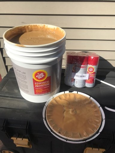

Well it's that time of year again to Fluid Film the truck. I was very pleased to find that about 75% of what I sprayed on last year was still there. The high wash areas needed to be reapplied but that's it really. Very please with how my 6.5 year old truck looks underneath.
@U&A thanks for the tip on Fluid Film AR, I applied it to the wheel well lips last year and it's still there! Stuff is tenacious as hell!

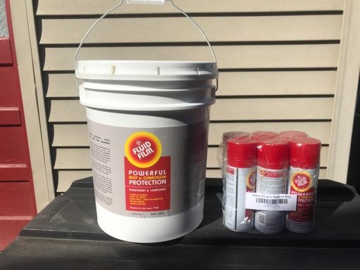

Corey and i have been talking about this stuff. Let is know your thoughts
https://nhoilundercoating.com/
Here is what i have to say.
FYI: Corey and i both can not argue with the results of FF.
Im interested. But like you i cant argue with FF result.
I also already have a hard time paying $39 for 1 gallon for FF. That NH oil is the closest in price (compared to others) at around $49 for 1 gallon
FF 5 gallon is $182.99
NH oil 5 gallon is $199.99
I will MAY try it next time IF im feeling up to the cost.
But the kicker is the spray cans that i use for doors and stuff.
FF cans are $8 if you buy individually
NH cans are $29
FF case of 6 is like $6 a can
NH case if 12 is $12 a can...... **** me that is to much man.
SO **** THAT. If I do use NH oil it will only be in the gallons and I’ll still use fluid film in the cans.
The other thing that I used to worry about is the plastics under The truck. But I guarantee (now after experience) the plastic that is under the truck is oil safe. I bet even all the rubber is to. The only thing that I know for a fact that does not react well with fluid film is your door seals. The bottom of my drivers door seal doesn’t have a straight spot on it.
Good to hear.
This year im hoping to take the time to remove my wheel well liners and clean that lip off real good. Than apply AR
