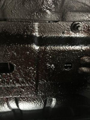

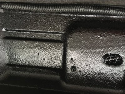

CF09516F-233E-4F57-8804-3F2638FB726B.jpeg BA621642-7E5D-498D-9371-C6376DD9B644.jpeg I wonder what they used from the factory/dealer. This stuff is going on 8 years old and still looks like it did when I bought the truck new. And I see a **** ton of salt. It's a waxy like substance but doesn't seem to attract dirt (it is black though so maybe that has something to do with it). Dirty as hell though when working on the truck, but that's a fair trade off I guess...

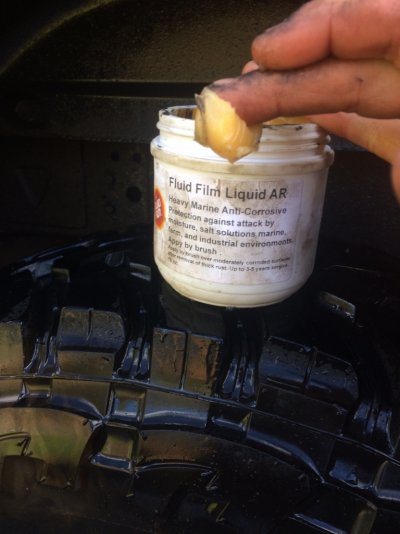

Had a late start getting the winterization of my truck done this fall. I’ve had a lot going on with my truck the past month
Started pulling the wheel well liners off of the truck today to clean the mating surface between that and the fenders. It’s amazing how packed full of crap they get and I cannot believe all my other vehicles I have not done this before. Goes to show where all the rust comes from on fenders.
Got the two rear wheel fender liners removed, cleaned out andThen I applied fluid film AR on that mating surface so it’s sandwiched in between the wheel well liner and fender.
and actually just used my fingers to put it on this time. Messy as hell but much easier as it goes on in a similar consistency to cold bacon grease or lard.
Last year I did the same thing it was the first year are used it. I also applied it to the pinch weld on both sides all the way around the bottom of the truck..
Today when I wash the undercarriage The fluid film AR was still on all the pinch welds. I still ended up power washing it off best I could to remove the dirt that had stuck to it. After the fenders are done I’m going to go back around all the pinch weld with AR.
If you’ve never tried fluid film AR and are looking for something that will stay for a very long time in certain spots try it out. Just remember it has to be applied by hand. there’s absolutely no possible way for this to be sprayed on.
Ill post a few picks of it later
U&A
Apr 29, 2016
9,387
18,966
Michigan
2016 3500 SRW
6.4 HEMI
Fluid Film AR. Says right on the container 3 to 5 year service. I could easily see 3 to 5 years of service out of this product even in the wheel wells with the high spray from the water. But The dirt it collects in that area 09259bfb5bb5c69a3ff17caf7b688e69.jpg I’d rather R&R every year.
