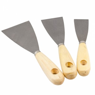

I have used a trowel I think the name is on that thick stuff
I would not want to use a metal trowel on the inside of the panels in the wheel well area. Scratching the “galvanized” coating is not good.
JMO
I like the idea though. Maybe a plastic one?

What about a spreader for body filler? They're pretty flexible and you could pack it into the seem between the wheel well liner and the the lip. The preventative Hack N Pack so to speak...

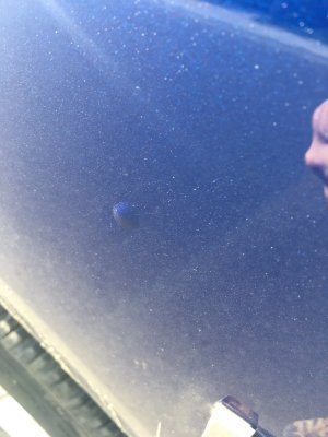

So I've got to revive this thread and ask for some input. Specifically on the front driver's side panel with that fiberglass tape crap. I have a bubble in my paint forming slightly above the hemi badge. I'm gonna go to a body shop today and see if they can give me an estimate on a repair. I'm terrified that it's rust! It started as a small pin size and now it's grown to the size of a small marble in a matter of months. I'm assuming they'll just sand it down and repaint it. Is it a good idea to drill a hole below that taped piece so that I can get some fluid film in there?

I'm sorry to say that is most likely rust from the back side of the fender from that damn fiberglass tape. They will most likely just replace the fender. If they sand that down it will just reveal a hole.
Your best bet when you get a new fender is to remove the fender liner and coat the crap out of that tape with FF.
That's what I was afraid of. Man, what a stupid problem to have on a 4 year old truck! I think Chrysler has a 5 year 100,000 corrosion warranty if I'm not mistaken. I'll see if I can get it covered. When it's fixed I'll be fluid filming the crap out of that tape!

Got an update, the body shop didn't want to touch it without having the dealership look at it first. He was afraid it was rust like we discussed here. He said he hasn't yet seen a 4th gen with this problem. He's seen it on Fords but not Ram trucks yet. He also went full nuclear and was scared that it was delamination lol.
I contacted the Toyota dealership I bought the truck from and they are doing some research into what my options are. Also sent an email to Chrysler to see if they can give me some guidance as well. Hopefully this gets resolved quickly!

Got an update on my rust issue! Finally got time to take it into the local Chrysler dealer today. They took some pics and said it might take a few weeks. The guy said it looked to be a textbook warranty issue. Apparently Chrysler thought it needed to be expedited because the same guy called me not even 2 hours later and told me that they would cover it 100%!
I asked about the repair to make sure it was done properly and he said they would replace the entire fender. Thankfully they'll also be giving me a loaner for a couple days. It's probably a good thing I've waited this long because the paint started to bubble even more. It was starting to look like crap, kind of embarrassing on such a nice truck!
I did end up checking the inside where the tape is on the other fender and sure enough there was rust starting to form on the lip so I sprayed some rust inhibitor on there, cleaned it off and fluid filmed the crap out it. Hopefully that side will hold off for a long time! Thanks for the advice on this guys, it wouldn't have worked out without the help of this thread!
