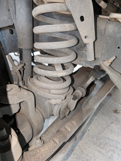

Actually, i think it probably hits that pack with every day driving with his setup, even without towing. He has the factory air option, so the leaf pack is very light duty in comparison to a normal 1 ton.
olyelr
Nov 18, 2018
5,560
4,582
Kewadin MI
Per your question in the pm you sent me, the sway bar link is what attaches your sway bar to your axle. The joint where the arrow is looks quite blown out…

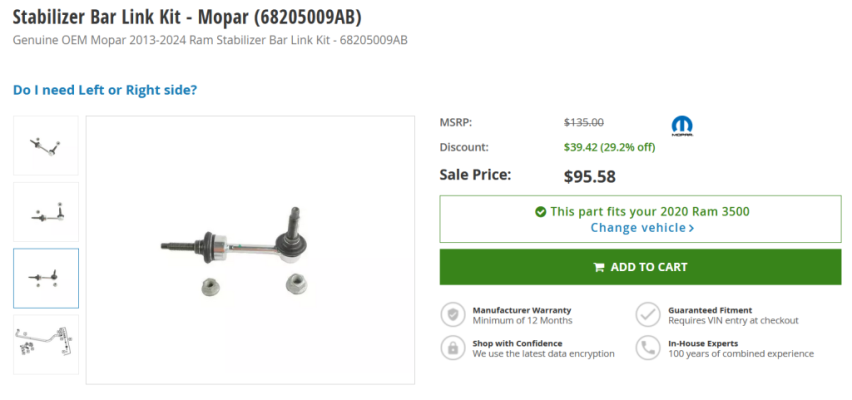

Thanks. I did some research after I saw your comment and believe I found the OEM replacement...did does look a bit different. I'll get under there in the next couple of days and get a better look at it. Also watched a couple videos on how to replace and seems straight forward.

Welcome! Yep thats what you are after.
Straightforward easily replaceable part. But rust and corrosion might fight you a bit.
