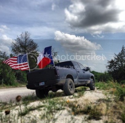

Hey great idea thanks for sharing. If anyone is ever worried about them coming out just drill a small hole below the first strap and put a hitch pin in it :) and to anyone worried about it messing up or hurting your truck it's 8 tiny holes no one will ever see. And it's sad to see people be so rude about being patriotic. Rock on! :favorites13:

No problem, and thank you! :favorites13: Thats a good idea, even a small cotter pin would do the trick

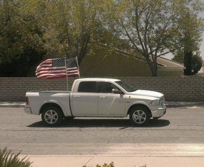

I did this to my truck, minus the Texas flag cuz I live in CA. I only did it for the 4th of July and I plan to do it for Veterans Day ( I am a vet) and on 9/11 (never forget). Some people made comments on this being tacky. However, on a few days of the year I see it as patriotic and supporting the troops.

Looks great! And thank you for your service!

Looks great man, and thank you! :favorites13:

So I get people all the time asking me about my flag poles and how I mounted them. Ive seen many people mount them different ways and spending tons of money, while none of them I really cared for so I came up with my idea.
Total cost for me was about $5, more if you dont have any screws..
I used a 10ft piece of 3/4" metal conduit that I cut into two 5ft sections. Then I bought 4 1" metal straps(sold right next to the conduit in stores). Where you can see in the picture I just put one strap on bottom and one on top and used the self tapping screws to secure them. On the poles I just drilled holes and have my flags zip tied on, you can bolt them or however you want.
Ive driven at highways speeds and never had a problem with the poles moving or bending or coming out and Ive had these for over a year now and Ive done this for friends trucks too. Only thing is the flags can get torn up after a while or from driving too fast. I always have the metal straps attached to my bed so the poles can be easily removed when I dont want them. Ive had to replace two straps from **** in my bed hitting them and bending them but other than that no other problems.
Now my poles are painted lime green too:naughty:
:patriot::patriot::patriot:
Love the concept, done it myself before. Only thing I ask is you switch the flags from side to side. American flag should be flown infront of or to the presenters right.
