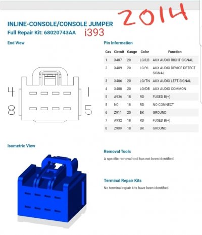

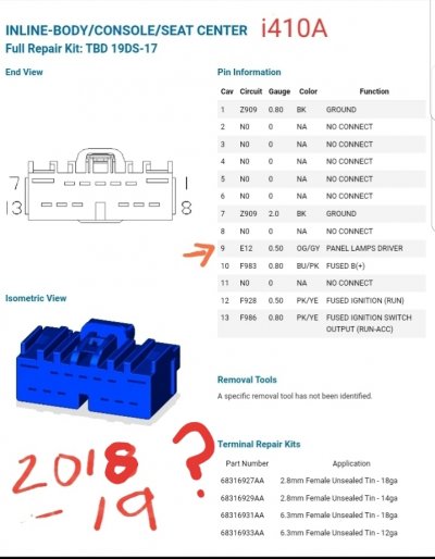

Looks like the center console connector I410A pin 9 is listed as All Aariants, circuit E12, Panel Lamps Driver, OR/GY 20 gauge. I haven't traced it out to see where it goes on the console end but it's a start.

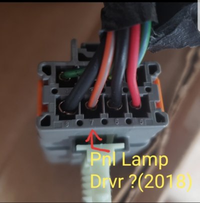

Pin 7 at the base/hinge of the lid's 8 pin connector.

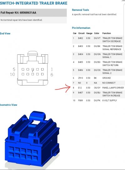

My suggestion would be to cut it on the truck side and splice in a new wire to run to the back of the trailer brake switch connector (pin 8) to get the Panel Lamps Driver signal.

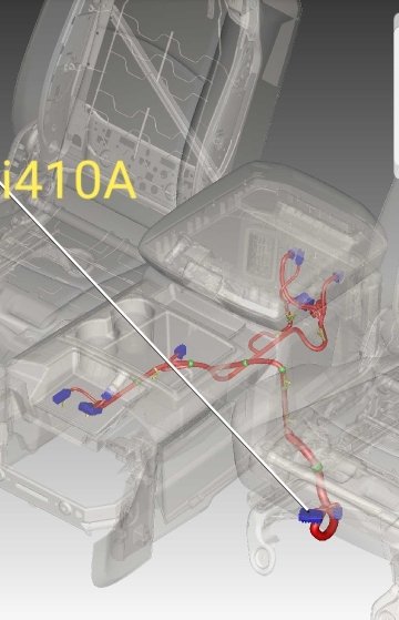

On the 18 (19 classic) trucks, the Pnl Lamp Driver signal is at the i410A pin 9 under the seat but despite tech authority/DCCtools connector info, I don't think that exists on the 13-17 trucks (trailer switch always had the signal & is the next closest spot).
