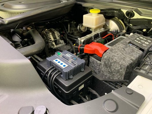

This is the second part to my light bar installation where I install the Trigger 4-plus wireless controller. Overall it does what I need it to do and simplifies the light bar install for my lower grill and future lights BUT the design of the switches is a little underwhelming. I’ve been very vocal with AAC the company that manufacturers this kit about the perceived feel of the controller.
Again does exactly what I need it to do but the switches are meh for a $200 controller.

Watched your video. Did it just how I plan to. I did a 6 shooter install on a buddy's Colorado. Figured I would spend the extra for a couple more circuits. I agree the switches are the only downside on what I consider a premium setup. Everything else is done well and I'm very picky about my 12v installs.
I think one descent light bar up front.
Ditch lights.
Warning strobes.
Backup lights.
Deer whistle.
Good video and walk through. I'm weird in that I like watching people do stuff I've already done just look for extra thoughts or better suggestions! Good work. Also going to check some of your other videos.

Just installed the Trigger 4 in my 21 2500 Lariat. Easy install. Waterfowler41 has a 1500 so I knew I needed to find a different fuse to connect the yellow trigger wire to.
I found something very useful while investigating which switched fuse I wanted to use. If your truck has the 12v power outlet in the upper tray on top of the dash, it probably comes from the factory with the power port on all the time. I have my radar detector currently plugged in there (will direct wire later). I would like the port to be switched 12v. Well, killed 2 birds with this find. Fuse 90/91 controls that power port. That fuse position actually is a 2 way fuse setup. It comes shifted to the right which has the power port always on. If you pull the 20A fuse and move it to the left position, the power port is now switched! So, I installed a fuse tap in the left position and connected the trigger wire to that.
Works great! Easy way to add switched devices if you don't have the factory aux switches.

It's a good system. My buddy's truck is about 7 months since instal. Had one item randomly turn on one day in the driveway when he wasn't there. The only theory is garage door opener but it's BT so I don't buy it...
Minus the physicality of the switches, it is the best most complete solution.
And that is funny on the fuse. My tradesman came factory in the other position because my all band scanner only receives power when ignition is on.

Unless you absolutely need power when the vehicle is off, powering the trigger off of a switch circuit avoids that issue altogether.
