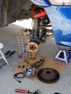

Ok guys and gals how many of you have had to replace any of your wheel bearings on your lifted Rams?
What kind of miles are you seeing out of them? How much did it cost you to replace them?
I went with Rock Auto. Timken is $80 a pop and 2hours of my time for install.
Major reason the bearing failed was because it got into a fight with a Subaru at 50k miles:anitoof:
No damage to my vehicle at the time other than some scuffs to the rim. But eventually this was the outcome. Not to bad for $80.
I was really surprised to see how much brake pad I have left. Stock brakes with 78k should easily pass 100k
