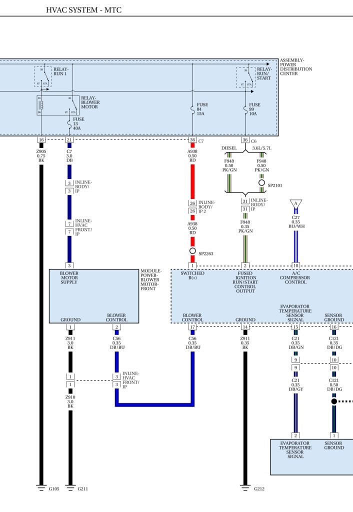

2019 Ram 1500 Classic. My hvac blower has quit working. Ive replaced the blower, tried a second new blower, checked the underhood fuse, and swapped with a known good underhood relay and the blower will not run. The blower has the 3 wire connector plugged in to it. I have 12v on the 2 large wires and also 12 volts on the small middle wire to ground that varies from 9 to 12 volts when changing the fan speed. The truck has the touchscreen/knob fan controls with dual zone temp. Im not sure what else to check. I assume it could be something to do with the signal wire but i have no idea.

You may have a bad/missing ground at one of the larger pins (pin 1 ) if you have 12v on both sides?
As the voltage control signal (pin 2) changes, the fan should speed up.
