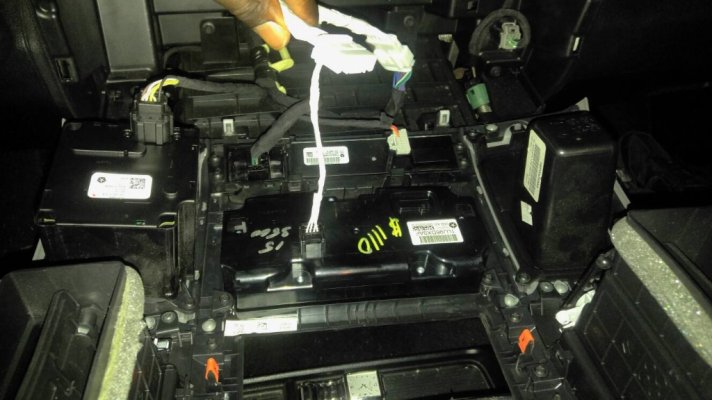

I have a 14 ram express and I upgraded my radio and bezel to the single zone 7 speed interface. I got the harness from get up kid, but the hvac harness does not fit the module. 8c9935440004c39c61f4e9d57aa05e97.jpg

In case you missed it ....
DIY: 2013+ RA3/RA4 8.4" Radio Conversion Upgrade
(There's also an instruction sheet you can download in post 2)
Basically the 24pin connector doesn't plug into the back of the bezel, only the 8 pin.
A separate HVAC module (must be purchased) plugs into the 24pin connector.
So on the 7 speed conversion harness' 3 connectors ...
24 pin (P1) to existing truck connector
24 pin (P2) to new HVAC module
8 pin (P3) to new bezel

Thanks

im planning on doing the same upgrade but i already have 7 speed fan, do i still need hvac module?

Yep you need the harness and module. Worked like a charm

I recently upgraded my 2015 Ram 1500 with a 7 speed fan from the 5.0 to the 8.4 with the new HVAC module and wiring harness. The problem I am having is the fan shuts off when put on speed 7 and the A/C does not work (does not blow cold air). Everything works with the old bezel so it must be an issue with the wiring harness or HVAC module. Has anyone run into this issue?
