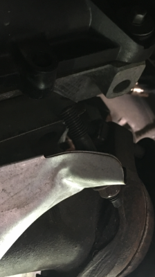

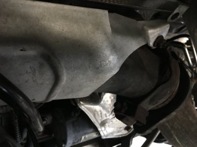

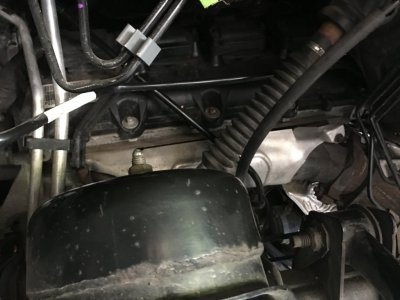

It’s the one on the upper part that holds the heat shield stud.
I did this job on my old Chevy with 250k on it.
No tackling this one, I’m tired of battling this kind of jobs.
Regardless, I’m having both sides manifolds replaced.

Those pics aren't the manifold bolts that are the usual problem, its the bolts that hold the manifold to the head that break. If that's the only leak you have its an easy fix.
