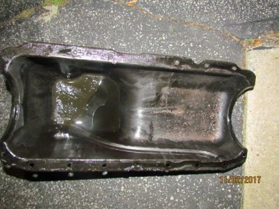

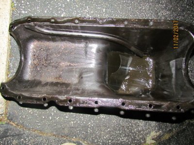

Ok, had a chance to pull the oil pan. I must say it was quite easy to do, as you would expect with a big 2500 4wd. I only had to remove the engine mount-to-bellhousing brackets, pull the starter, take off the torque converter dust cover, and remove all the pan bolts and the pan came right off. When I drained the oil there was nothing out of the ordinary, no lumps/chunks flowing out. The pan definately has debris in the area of the front, shallow end. Looks like shake pepper sized pieces of bearing probably. I didn't notice any rods that got blued from heat. The engine turns over with a wrench easily. all the rods react to crank motion. Still think it's rod bearing(s). Next time I'm out there I'll pull all the rod caps 1 by 1 and inspect them all. Here's a shot of the pan contents:

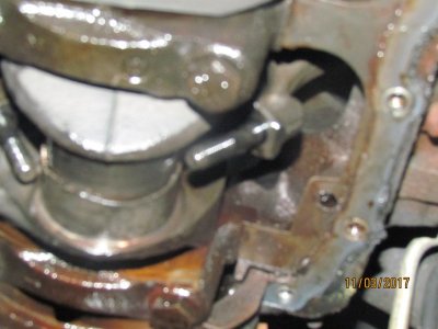

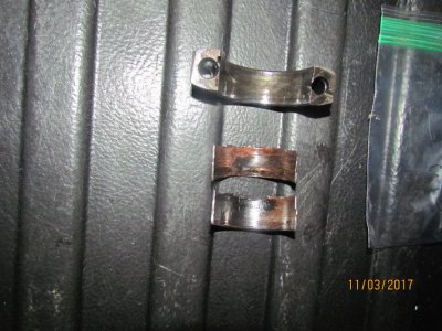

more investigation. Yep. Spun #1 rod bearing. The #1 rod bearing halves actually got stuck together and were a fused full ring around the crank journal. Surprisingly, the #2 rod bearings survived unscathed. Both bearing halves of the #2 rod were showing normal, with no sign of trying to spin. The little tangs were all still there.

You got some messed up bearings my man. With how bad those bearings are, you likely wore down the rof journals, if they aren't gouged up.
Did you measure the rod journals or just put regular bearings back in? With bearings that messed up you'll need to plasti-gauge or mic the rod journals to figure out how undersized the new bearings need to be. If its still knocking i'd guess a thou or two should be sufficient, but you'll have to measure to be sure. Either way, unless you have that crank machined, its going to have a much shorter life.

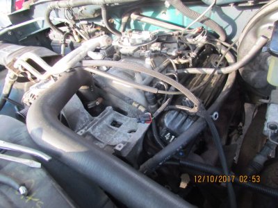

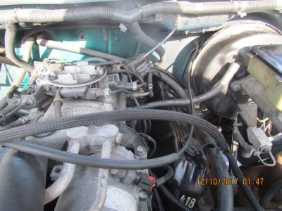

my next goal is to remove the intake, and drivers side cylinder head. well today I had a chance to mess with the truck a little, and i drained the coolant out of the engine. I have already removed the serpentine belt, unbolted the power steering pump and left it aside, I also removed the a/c compressor, and have the lines unbolted such that they can just be laid to the side.
I'm looking at the wiring and vacuum lines on top of the intake and wow, there is a ton of stuff. I guess I have to find a way to make it the least amount of disconnects to avoid unneeded disassembly, but it looks like the wiring for the injectors is all hard-wired from the harness that drops down from the cowl, so all that wiring needs to be taken off. Same with the vacuum lines I guess.
Any time-saver tips like the earlier one about unbolting the throttle body and laying it aside, much appreciated! IMG_2216.JPG IMG_2220.JPG IMG_2220.JPG

You'll have to take the whole wiring harness off the intake as you have to pull the intake to unbolt it from the head. Don't even bother trying to remove the head without pulling the intake, its asking for trouble. There are no shortcuts for removing the wiring harness, you just have to follow it around and unplug everything, even the cam,crank, oil pressure sender connectors to make it easy to move around. There is a ground strap on both the front and back of the head, make sure to unbolt those, don't unbolt the rear strap from the head, just unbolt it from the firewall, its much easier.
Undo the wiring harness and move it aside, then you can unbolt the intake, if it already hasn't been off, order intake bolts and a gasket set now. Also if you haven't dont the plenum repair, order a felpro plenum gasket and if you want new plenum bolts. Soak those intake bolts in your favorite libation a day in advanced to get some of the rust broken loose. Then if they don't come out easily, don't force them, just rock them back and forth (tighten and loosen) until they break loose, snapping them isn't and automatic destruction of the heads, but snapping too many can cause issues.
Next would be pulling the valve cover, blow off all the junk first. When thats off, unbolt the rocker arms so the lifters and pushrods are no longer being compressed, and remove the pushrods. Tip: take a piece of cardboard and skewer the pushrods through it and ziptie or wire twist the rockers through the cardboard and label them, this will prevent getting them confused. Then you can undo the exhaust manifold. Order a set of exhaust bolts and studs now, those things are bound to be messed up. Don't be afraid to hammer the next size down socket on them, you don't want to round those babies off.
Once everything is off the head you can start unbolting it. I'd suggest following the reverse procedure of install to slowly let stress out of the head. That means loosening the font and rear most bolts opposite corners first, then moving your way in opposing corners fashion until you get them all out. That should give you the best chance not to crack or further crack the head. From there, it should lift off with a bit of elbow grease.

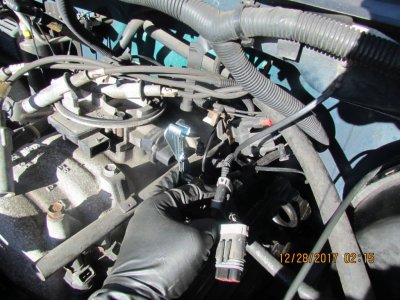

Question regarding disconnecting the fuel line- I can't seem to disconnect the fuel line, it's the metal-style connection. I bought a fuel line tool that works on either 3/8 or 5/16 line. seems like it fits either size, but it won't budge the fitting. Is there a trick to disconnecting this fuel line? See pics.IMG_2241.JPG IMG_2242.JPG IMG_2242.JPG IMG_2243.JPG IMG_2242.JPG IMG_2243.JPG
Micchi
Feb 25, 2012
254
71
West Lawn, PA
1999
5.2L
Question regarding disconnecting the fuel line- I can't seem to disconnect the fuel line, it's the metal-style connection. I bought a fuel line tool that works on either 3/8 or 5/16 line. seems like it fits either size, but it won't budge the fitting. Is there a trick to disconnecting this fuel line? See pics.View attachment 116739 View attachment 116740 View attachment 116740 View attachment 116741 View attachment 116740 View attachment 116741
Try pushing in on the line and see if the tool will slide in further. Should just pop off then.
