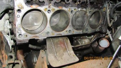

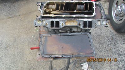

Hello, now that we are starting to sorta thaw out in the northeast (although it was snowing overnight last night!) and had to brush the car off this morning, we had some nicer weather so I was able to get the engine torn down some more. I pulled the intake, didn't break any bolts but one in the front passenger side (as you would expect with the adjacent cooling connections) needed the torch to heat up the surrounding metal to remove it. The EGR tube fitting at the back of my intake was a PITA but I got it removed. My exhaust manifold needed at least 3 of the bolts helped via torch, but again no broken bolts or studs. I hammered on a 12mm 6 point socket onto most of them to get good wrench grip.

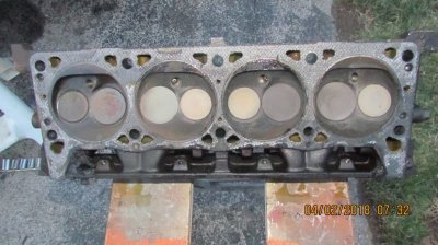

I got the head pulled tonight and then had to stop working on it. Took a couple pictures. So far the head looks fine to me regarding cylinder #1. Nothing obvious for damage to either of the valves. I'll take those valves out and fully inspect the seats and valves to be sure. The #1 piston also had nothing too obvious except looks to me like a small piece got chipped off the top of the piston at it's lowest (6 o'clock position on the piston with 9 oclock being towards the front of the engine.) My next step is to pull the pan again and then ultimately remove the #1 rod/piston assembly to fully assess the situation. Will report back what I find out.

Something significant happened in cylinder one to break that piston. I suspect you'll find more damage when you pull it out. Have you checked to see if that piston actually moves when you turn the engine over, and reaches the same stroke as the others?

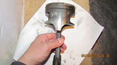

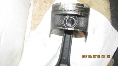

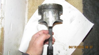

Tonight I got the broken #1 piston out. Looks like the upper compression ring area got all smeared-over and the rings were all stuck "in" so no compression being generated. Also, major damage to the wrist pin area of the piston on both sides, see pictures. So now I have the full picture on what happened to cylinder #1. IMG_2340.JPG IMG_2336.JPG IMG_2337.JPG IMG_2338.JPG IMG_2336.JPG
I'd be surprised if you don't find the intake plenium gasket sucked in where that cylinder draws its air from (right front corner). The oil reduces the octane and the resulting detonation kills the piston. And it's hard to hear detonation in a truck when it's only 1-2 cylinders getting hammered, especially front ones.
Interesting, I should have the intake pulled apart soon, and when I do I will report back my findings

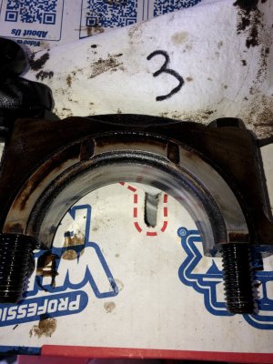

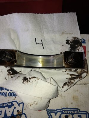

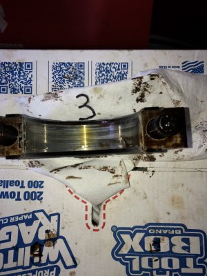

More post mortom analysis. Today I pulled the 1, 2, 3, and 4 main caps to see the status of the main cap bearings. number 1 looks good, however number 2 sustained pretty bad damage, although doesn't look to have spun, but the bearing surface is rough and the one edge is chewed up. number 3 looks like it was just starting to get damaged right on one of the ends where it meets the other bearing half. the rear facing thrust surface was starting to wear down to the copper. number 4 looks good. I didn't get a chance to pull number 5 today but I'll post up what that looks like once I pull it.

D78428B6-83B8-4432-B645-B09CEB8B535E.jpeg I’m back in action! Got the truck running again and took it out for a shakedown drive. I ended up replacing all the main bearings as well as the rod bearings and that piston. Good to be behind the wheel of the beast again!
