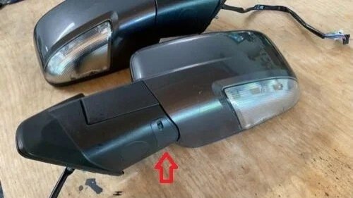

The ambient temperature sensor is located in the driver side outside mirror. Look at the bottom of the mirror and you will see it.

Sounds like an aftermarket mirror maybe without sensor

yes.. i have aftermarket mirrors without sensors.. but i drive the mirrors since 5 years.. the -40 degrees problem is 1 month old

Sounds like whoever installed mirrors moved the sensor.
Maybe inside door panel since that is where the wiring for sensor is supposed to be

I agree with @crackerjack1957's post here. I have worked on a few trucks that had aftermarket power folding tow mirrors installed and the ambient temperature was relocated inside the door panel and zip tied to the harness. The aftermarket mirrors did not have the provision for the ambient temperature sensor.
