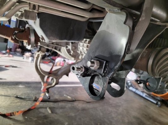

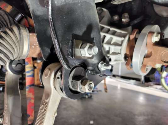

For me it's a few things. First, the knuckles are aluminum rather than steel or cast iron as the other kits, less weight for the suspension to control. The knuckles also move the wheel hub 8mm forward, and the tie rods are moved up and low profile ends are supplied to avoid any bump steer. Lastly the skid plate becomes a part of the structure moving the differential off the motor mounts while increasing clearance and making the skid plate part of the support system stiffening the entire structure.
Yeah for the price difference you paid, that is well worth it!

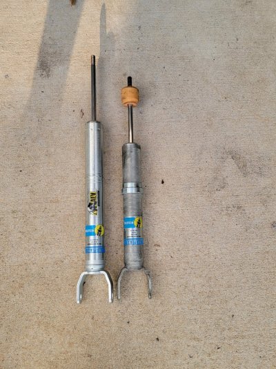

Looking good. I wonder how those bilstein will feel compared to the regular 5100. Pretty interesting. I want to swap my 5100s to 6112s so bad but buying that snorkel was my chump change for a while.
Yeah I hear that.
I'll let you know once the rear is done and I put a basic alignment on it in the garage so I can do a shake down.
Front took nearly 11 hours. I'm hoping the rear is way faster as it's brackets and shocks.

Back side is done. Late start to the morning. Anyway. It's this close backing out of the garage.

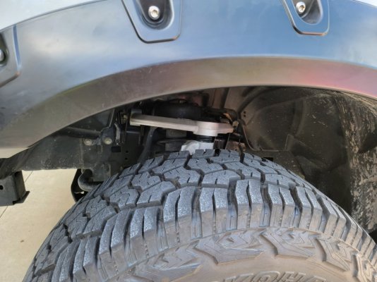

Balljoint angle with the RC upper control arms.
I didn't think that the AEV kit would be so dramatically different from the other options out there! I can't wait to see/ hear how you like it.
Are those the stock height or the 3" lift RC UCAs on there?

Stock height. I had ordered the 3" to replace my stocks as the ball joint was moving. But then the lift came back in to stock and I figured they designed it to use factory control arms so I should go stock height instead.
I'm still in recovery mode right now. I'm going to go back over all the critical bolts and retorque everything then to a temp alignment in the garage. Hopefully the alignment shop down the road will get an opening in the couple weeks. They're normally booked weeks in advance.
