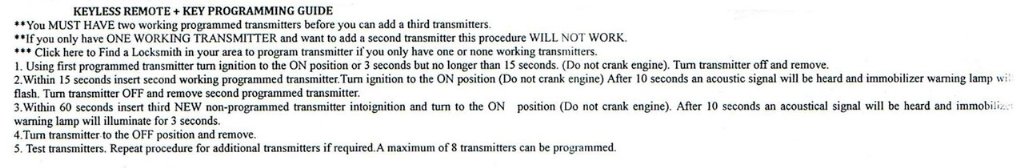

BTW, the eBay fobs I got stated they can be programmed but two working fobs are required! See attached for the instructions they provided. Has anyone seen these instructions before? Are two working fobs really needed? Why? I only have one working fob.

I don't know about the 2014 RAM, but my Jeeps needed 2 key fobs to be able to program additional fobs yourself. Those can be done without a pin or program tool. It tells you how to do the programing in the user manuals of the jeeps. So "if" the 2014 is the same way that would explain it.

This method only works on FCA vehicles that DO NOT use an RF Hub, so, 2013+ rams it won’t work for. The Jeeps were probably years that didn’t use rf hubs, also.

Damn it! Looks like I will be returning these. I should have checked closer... Thanks
