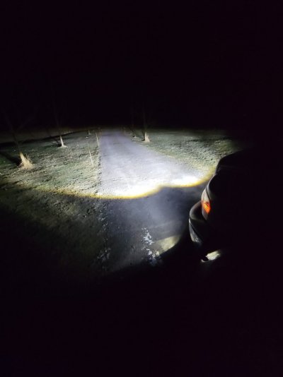

I had them lined up very similar to the way my 3500's headlight are set, before trying to figure out why the passenger side wasn't working.20221226_201803.jpg

I had them lined up very similar to the way my 3500's headlight are set, before trying to figure out why the passenger side wasn't working.View attachment 510356
Looks good. My very first attempt I was so happy got a lot done then put them in to see how they were aligned and they were pointed at the stars lol. Next attempt point at the ground. Finally figured I would power them with a 12v tester and I could pull them out and adjust Made it a lot easier.

Looks good. My very first attempt I was so happy got a lot done then put them in to see how they were aligned and they were pointed at the stars lol. Next attempt point at the ground. Finally figured I would power them with a 12v test and I could pull them out and adjust Made it a lot easier.
SOrry, that's the 3500's lights....I had the HID build look like that. It's funny, every video or picture I've seen shows the HID cutoff lines lined up top to top, not what OEM is like on my 3500.
