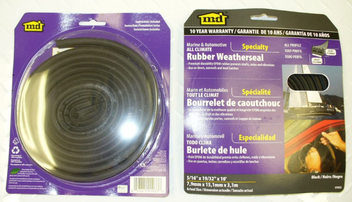

Thanks for the info. Glad to hear you got yours replaced under warranty....even a week out. I used a garden hose and tried to pin point where the leak is on mine. Water leaks are tough though! I' wasn't 100% certain. In the meantime, I replaced the gasket on my aftermarket Recon 3rd brake light. When I installed it a few months ago, the gasket seemed really good maybe even twice as thick as the OEM gasket. After pulling it apart, it seemed super compressed in some spots. I replaced the gasket with this, the same as I used on my 4th gen:
